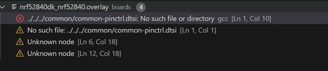

  • Ok, I totally missed this but this actually a known issue. Let me discuss this internally and come back to you,

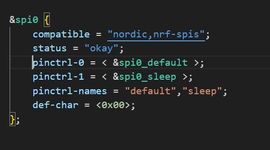

  • hello Jared,
    i have created a new custom board and have configured SPI0  in pinctrl-dtsi file. and also included  pinctrl-dtsi file into dts file.
    i want to use SPI0 in slave mode
    i am  getting configuration incomplete error message may i know which configuration is remian to add here?

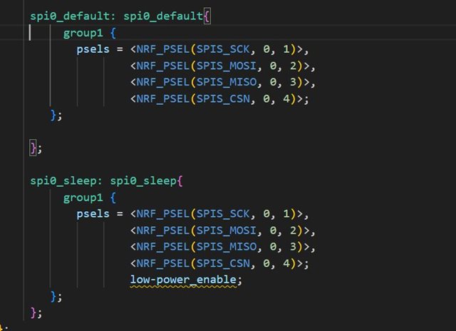

    devicetree error: 'low-power_enable' appears in /pin-controller/spi0_sleep/group1 in D:/Donaldson/Practice/nRF52840/myApps/led_blink/build/zephyr/zephyr.dts.pre, but is not declared in 'properties:' in C:/ncs/v2.5.2/zephyr/dts/bindings\pinctrl\nordic,nrf-pinctrl.yaml

    To answer your original problem. It's an issue because the #include statement in the overlay use relative paths. The solution is to manually change it so that it points to the common folder in your sample folder. For example, when you create a new sample based on the mentioned sample it will also create a "common" folder. The path in the overlay should point to that folder.
