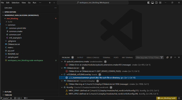

Hello Team,
example: SPI master_slave advanced non -blocking
i just open nRF connect sdk example in vs code and build it
I am getting below error while build
Please suggest a steps
i want to use nRF52840 as a spi slave device
Toolchain: v2.5.2
SDK: v2.5.2
    Are you able to build the project without any added overlay?

  • Ok, can you also share the actual build logs not from the "Problems" section but rather from the terminal?

  • Executing task: nRF Connect: Generate config nrf52840dk_nrf52840 for c:\Users\Pravin.Adsare\non_blocking
    Building non_blocking
    west build --build-dir c:/Users/Pravin.Adsare/non_blocking/build c:/Users/Pravin.Adsare/non_blocking --pristine --board nrf52840dk_nrf52840 --sysbuild -- -DNCS_TOOLCHAIN_VERSION=NONE -DCONFIG_DEBUG_OPTIMIZATIONS=y -DCONFIG_DEBUG_THREAD_INFO=y -DCONF_FILE=c:/Users/Pravin.Adsare/non_blocking/prj.conf -DBOARD_ROOT=c:/users/pravin.adsare/non_blocking
    Loading Zephyr module(s) (Zephyr base): extensions sysbuild_extensions python west root zephyr_module boards shields sysbuild_kconfig
    -- Found Python3: C:/ncs/toolchains/c57af46cb7/opt/bin/python.exe (found suitable version "3.8.2", minimum required is "3.8") found components: Interpreter
    -- Cache files will be written to: C:/ncs/v2.5.2/zephyr/.cache
    -- Found west (found suitable version "1.1.0", minimum required is "0.14.0")
    -- Board: nrf52840dk_nrf52840
    Parsing C:/ncs/v2.5.2/zephyr/share/sysbuild/Kconfig
    Loaded configuration 'C:/Users/Pravin.Adsare/non_blocking/build/empty.conf'
    Merged configuration 'C:/Users/Pravin.Adsare/non_blocking/build/empty.conf'
    Configuration saved to 'C:/Users/Pravin.Adsare/non_blocking/build/zephyr/.config'
    Kconfig header saved to 'C:/Users/Pravin.Adsare/non_blocking/build/autoconf.h'
       * Running CMake for non_blocking *
    CMake Error at CMakeLists.txt:11 (GET_DEVICE_CONFIG_FILES):
      GET_DEVICE_CONFIG_FILES Macro invoked with incorrect arguments for macro
      named: GET_DEVICE_CONFIG_FILES
    -- Application: C:/Users/Pravin.Adsare/non_blocking
    -- CMake version: 3.20.5
    -- Using NCS Toolchain 2.5.20231017.848171396279 for building. (C:/ncs/toolchains/c57af46cb7/cmake)
    CMake Deprecation Warning at C:/ncs/v2.5.2/zephyr/cmake/modules/FindDeprecated.cmake:121 (message):
      'PYTHON_PREFER' variable is deprecated.  Please use Python3_EXECUTABLE
      instead.
      C:/ncs/v2.5.2/zephyr/cmake/modules/python.cmake:16 (find_package)
      C:/ncs/v2.5.2/zephyr/cmake/modules/zephyr_default.cmake:129 (include)
      C:/ncs/v2.5.2/zephyr/share/zephyr-package/cmake/ZephyrConfig.cmake:66 (include)
      C:/ncs/v2.5.2/zephyr/share/zephyr-package/cmake/ZephyrConfig.cmake:92 (include_boilerplate)
      CMakeLists.txt:13 (find_package)
    -- Zephyr version: 3.4.99 (C:/ncs/v2.5.2/zephyr)
    -- Found host-tools: zephyr 0.16.1 (C:/ncs/toolchains/c57af46cb7/opt/zephyr-sdk)
    -- Found toolchain: zephyr 0.16.1 (C:/ncs/toolchains/c57af46cb7/opt/zephyr-sdk)
    -- Found Dtc: C:/ncs/toolchains/c57af46cb7/opt/bin/dtc.exe (found suitable version "1.4.7", minimum required is "1.4.6")
    -- Found BOARD.dts: C:/ncs/v2.5.2/zephyr/boards/arm/nrf52840dk_nrf52840/nrf52840dk_nrf52840.dts
    -- Found devicetree overlay: C:/Users/Pravin.Adsare/non_blocking/boards/nrf52840dk_nrf52840.overlay
    In file included from <command-line>:
    C:/Users/Pravin.Adsare/non_blocking/boards/nrf52840dk_nrf52840.overlay:1:10: fatal error: ../../../common/common-pinctrl.dtsi: No such file or directory
        1 | #include "../../../common/common-pinctrl.dtsi"
    compilation terminated.
    CMake Error at C:/ncs/v2.5.2/zephyr/cmake/modules/extensions.cmake:3885 (message):
      failed to preprocess devicetree files (error code 1):
      C:/ncs/v2.5.2/zephyr/boards/arm/nrf52840dk_nrf52840/nrf52840dk_nrf52840.dts;C:/Users/Pravin.Adsare/non_blocking/boards/nrf52840dk_nrf52840.overlay
      C:/ncs/v2.5.2/zephyr/cmake/modules/dts.cmake:226 (zephyr_dt_preprocess)
    CMake Error at cmake/modules/sysbuild_extensions.cmake:455 (message):
      CMake configure failed for Zephyr project: non_blocking
      Location: C:/Users/Pravin.Adsare/non_blocking
      CMakeLists.txt:38 (ExternalZephyrProject_Cmake)
    See also "C:/Users/Pravin.Adsare/non_blocking/build/CMakeFiles/CMakeOutput.log".

    warning: NRFX_SPIM1 (defined at C:/ncs/v2.5.2/zephyr/modules/hal_nordic\nrfx/Kconfig:213,
    modules\hal_nordic\nrfx/Kconfig:213) was assigned the value 'y' but got the value 'n'. Check these
    unsatisfied dependencies: n (=n). See
    http://docs.zephyrproject.org/latest/kconfig.html#CONFIG_NRFX_SPIM1 and/or look up NRFX_SPIM1 in the
    menuconfig/guiconfig interface. The Application Development Primer, Setting Configuration Values,
    and Kconfig - Tips and Best Practices sections of the manual might be helpful too.
    warning: NRFX_SPIS2 (defined at C:/ncs/v2.5.2/zephyr/modules/hal_nordic\nrfx/Kconfig:246,
    modules\hal_nordic\nrfx/Kconfig:246) was assigned the value 'y' but got the value 'n'. Check these
    http://docs.zephyrproject.org/latest/kconfig.html#CONFIG_NRFX_SPIS2 and/or look up NRFX_SPIS2 in the

    CMake Warning at C:/ncs/v2.5.2/zephyr/CMakeLists.txt:1958 (message):
    See also "C:/Users/Pravin.Adsare/non_blocking/build/non_blocking/CMakeFiles/CMakeOutput.log".
    See also "C:/Users/Pravin.Adsare/non_blocking/build/non_blocking/CMakeFiles/CMakeError.log".
      instead.
    FATAL ERROR: command exited with status 1: 'C:\ncs\toolchains\c57af46cb7\opt\bin\cmake.EXE' -DWEST_PYTHON=C:/ncs/toolchains/c57af46cb7/opt/bin/python.exe '-Bc:\Users\Pravin.Adsare\non_blocking\build' -GNinja -DBOARD=nrf52840dk_nrf52840 -DNCS_TOOLCHAIN_VERSION=NONE -DCONFIG_DEBUG_OPTIMIZATIONS=y -DCONFIG_DEBUG_THREAD_INFO=y -DCONF_FILE=c:/Users/Pravin.Adsare/non_blocking/prj.conf -DBOARD_ROOT=c:/users/pravin.adsare/non_blocking '-SC:\ncs\v2.5.2\zephyr\share\sysbuild' '-DAPP_DIR:PATH=c:\Users\Pravin.Adsare\non_blocking'
     *  Executing task: nRF Connect: Build: non_blocking/build (active)
    ninja: error: loading 'build.ninja': The system cannot find the file specified.
    FATAL ERROR: command exited with status 1: 'C:\ncs\toolchains\c57af46cb7\opt\bin\cmake.EXE' --build 'c:\Users\Pravin.Adsare\non_blocking\build'
    Please check build logs from terminal
    two log files  attached are:
    1. spi non-blocking example_build_logs : No change in code
    2. removed board folder overlays files_logs: board folder deleted which contains all overlay files
    also, could you suggest a steps to use nRF52 in SPI slave mode.
    I have interface nRF52  to STM32 controller over SPI, so i want to use nRF52 in slave mode and STM32 controller in Master mode
    It seems that you made a totally new example based on the SPIM unblocking advanced example. I'm guessing that this new example is in another folder than the NCS folder?
