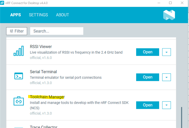

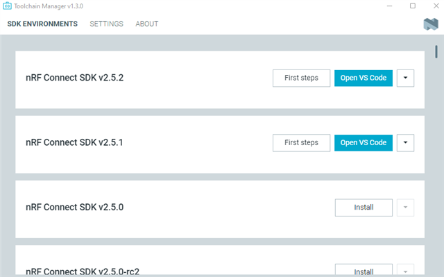

While following the "nRF Connect SDK Fundamentals" tutorial, my nRF Connect extension fails on the "Install Toolchain" step with error command 'nrf-connect.installToolchain' not found. I'm able to circumvent for now by using nRF Connect for Desktop and installing the toolchain with its Toolchain Manager, but still troubling that none of the commands seem to work directly from the VS Code nRF Connect extension. Nearly all nRF Connect commands similarly fail from VS Code including "Install SDK", "Manage Toolchains", "Check nRF Command Line Tools Update".

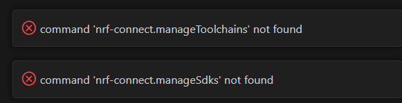

    This was a first-time install. After initial installation, this was the welcome screen:
    When trying to select "Install Toolchain" here or manually running "nRF Connect: Install Toolchain" via the command palette it gave this error:
    Trying commands "Install SDK", "Manage Toolchains", and "Check nRF Command Line Tools Update" in the command palette give similar errors.

  • I noticed that at some point after installing nRF Connect for Desktop, a new directory .nrfconnect-apps was created in my "home" directory (i.e. C:\Users\username\.nrfconnect-apps).  There is a bunch of stuff in there including node_modules which now has pc-nrfconnect-toolchain-manager.  My guess is that the VSCode extension needs this information to work.

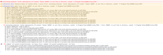

    Could you try one more thing?
    1. Click on Help → Toggle Developer Tools (and then select Console, if that is not already open)
    2. In the command palette execute “Developer: Reload Window”
    3. Select “Manage Toolchains” again, to trigger the error notification.
    4. See whether any additional output appears in the developer console, which might tell us anything about why the extension did not activate correctly.
    This might tell us more about what the problem is.
    Priyanka
  • Hi Priyanka,
    When I select Install Toolchain, the Developer Tools log that it is failing to find C:\Program Files\SEGGER\JLink_V794h. I currently have V794e. Interestingly, you can only currently download V794k and V794l from Segger.

  • Hi Travis,
    Could you check your windows registry and in case it contains incorrect entry, please fix it:
    HKEY_LOCAL_MACHINE\\Software\\SEGGER\\J-Link
    Also, you seem to have a .west folder in the C:\NCS . Please remove this as it is wrong and it's preventing the SDKs within this path from functioning properly.
