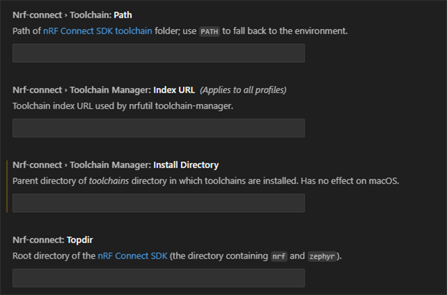

    The new settings for the extension are this:
    These settings are critical for the extension to run commands such as "Manage SDKs", so mine are obviously incorrect currently as any command run from the extension throws an error indicating that it cannot run any "nrf-connect.x" commands:

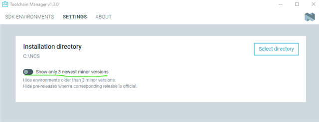

    Within this, please select the Toolchain Manager and go to the "settings" on the top left. There, please de-select the following option:
    This will allow you to see all possible nRF Connect SDK versions in Toolchain Manager and you can manage them easily.

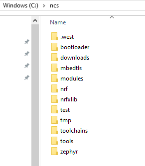

    Regarding the path location, it would be better if you could save all SDK versions in one place to avoid confusions. It can be either C:\ncs or C:\nordicsemi or C:\anything_of_your_choice. Just make sure that you have a small path length and not too lengthy ones, to avoid building errors related to this. This is how my path location looks like, for reference:

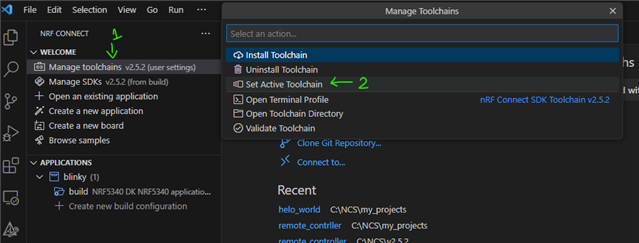

    Now, moving on to operating in the VSCode extension, as you had mentioned, the previous settings no longer exist, but the new ones are pretty user-friendly too. First, select the "Manage toolchains" option, followed by "set active toolchain":
    And this will allow you to select the required toolchain:
    The same applies for selecting SDK version too:

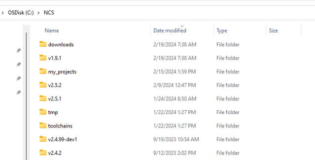

    Here is my cleaned-up SDK installation directory:
    Could you please provide any hints on why the nRF Connect for VS Code extension doesn't run the commands properly? I have tried both leaving default extension settings as well as setting the Toolchain Paths manually in User Settings and neither help. I have also tried completely uninstalling and reinstalling VS Code and the nRF Connect for VS Code Extension.
