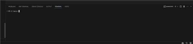

    I first installed nRF Connect for Desktop v4.4.0 and then used its Toolchain Manager to install both the v1.9.1 and v2.5.2 SDKs as Priyanka described earlier in this thread, so my ncs folder looks like this:
    I'm wondering if, to follow what you did Lenny, I should have only installed the Toolchain Manager using nRF Connect for Desktop then immediately go to VS Code to see if the Toolchain Manager would work and let me install install SDKs directly from VS Code.
      if you think I should try a different order of installing dependencies could you please give guidance on how to properly uninstall what I have and the preferred order? I'm particularly curious how to clear out the existing Toolchain manager and SDKs in my ncs folder.
