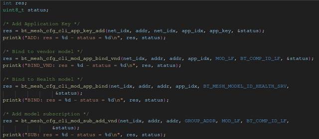

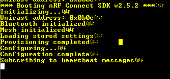

Problem is, using bt_mesh_provision to provision the node using hardcoded keys raises some errors.

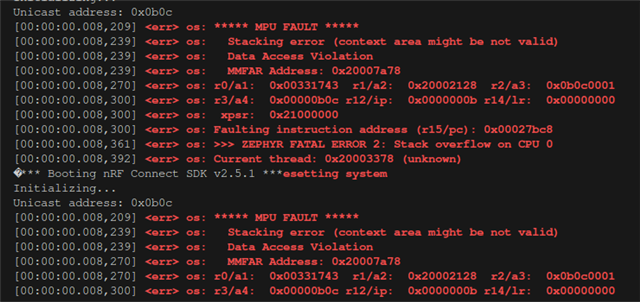

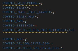

  1. MPU Fault when using CONFIG_SETTINGS=y. As shown in the image below, building and running the sample for DK 52840 produces a MPU fault that can be bypassed by setting CONFIG_SETTINGS=n in prj.cfg. (We're not experiencing this error in the project so I'll skip it)

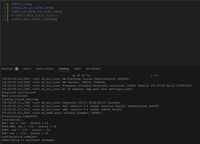

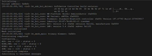

  2. After setting CONFIG_SETTINGS to n, the MPU fault disappears. Apparently the node manages to provision itself and to call the configure() function as the provisioning phase is over. This configure function uses the configuration client's functions to add a NetKey to the node, add a AppKey to the node, bind the AppKey to a health model and to a vendor model. Unfortunately, this does not work correctly as each of the functions return a -116 (ETIMEDOUT) error (as shown below).
I've been working with the 2.5.1 toolchain up until yesterday but the pictures were taken using the latest one, 2.5.2.

  1. Addition of printk functions as shown in the pic below to showcase the values of ret and status on different operations (as I'm having troubles debugging).
  2. Modifications of prj.conf file so enable logging and disable the settings subsystem.
A trace of the error (in one of the 4 functions) is:

    1. Grab your handy nrf 52840 dk
    2. Build and flash
    3. Add a terminal to the device
    4. Provision the device in the nrf mesh app
    The output should be:
    • app key 0 - addr = 2 - elem_addr = 2 - loc = 0
    • bind_vnd: err = 0, status = 0
    • bind: err = 0, status = 0
    • add_vnd: err = 0, status = 0
    This should prove that the synchronous and blocking behavior inside a callback that is faulty when using bt_mesh_provision is not faulty using the traditional provisioning protocol.

  • Hi Ale,
    Why don't you send me the code that has the issue (the one with work queue/thread queue that you said doesn't work)?
    The code you sent I assume works just fine with a phone, correct ?
    As I has explained to you earlier, you don't have an issue with a phone because the configuration client (the one add appkey) doesn't run on the chip when you configure with a phone. bt_mesh_cfg_cli_app_key_add() is the blocking part.
    The client is on the phone and that's why you don't have any issue with blocking problem.
    Please let me know if something is still unclear.
