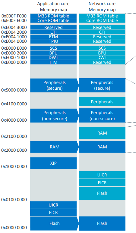

After flashing the netcore i cannot find the location where the image version is stored.
Could you kindly tell me if there is a way to retrieve the fw version of the netcore ?
