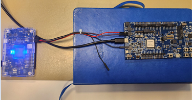

My system photo:
Results:
Concerns:
I was hoping to see the spikes every 1 second when the LED is turned ON but that does not seem to be the case. Additionally, there seems to be quite a bit of noise that looks like below when zoomed in:

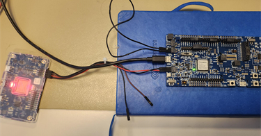

See my system photo:
Results:
Concerns:
The device does not seem to enter low power mode (current consumption is above 1mA. Also, I am not able to notice the spikes every 1 second when the LED is turned ON.

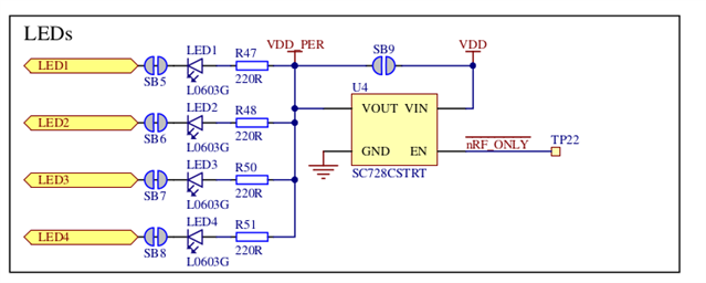

    When measuring current, it is important that you don't back-power the peripherals/logic around the nRF on the DK itself.
    You can find the schematic and layout of the DK on our website, for reference:
    https://www.nordicsemi.com/Products/Development-hardware/nRF52840-DK/Download?lang=en#infotabs
    I'm combining the answer on questions 1 to 4, as the root-cause is the same:
    It is because the LEDs are buffered through transistors, powered on a different voltage net.
    5. Regarding TEST5. Finally able to see the graph that makes some sense. The current increases/decreases at 1second intervals.. However the system does not seem to enter proper System ON low power mode when the task is idling.
    Here you are sourcing the whole DK, including switches/buffers/etc.

    7. So what is the truly correct way to measure the nRF52840DK current consumption? I am interested in the current consumption of the nRF52840 and all peripherals connected to it (LED's and whatever other sensors that I plug in and use). For this, I assume I should use nRF only mode to ensure the Interface MCU is cut off. But as I shown in my experiments above, when using nRF only mode the cpu does not seem to run properly - the LED's wont even blink.
    The correct way depends on what the requirements are. The DK is setup to only measure the nRF + what-ever is connected to the GPIOs (except for the buffered LEDs)
    As per yours, it includes the VDD_PER net, which will require that you connect some solder bridges and using the "NRF ONLY" position:
