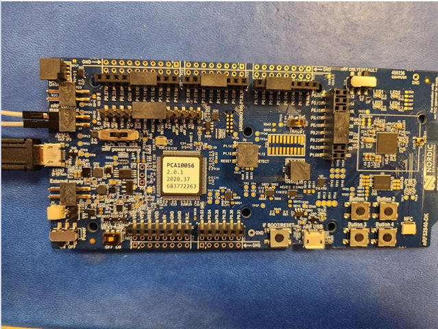

Hello. I have been experimenting with the nRF52840 and current consumption. I may have accidentally connected Li po battery terminals the other way around for a brief moment, also, I may have supplied around 4.0V via the External supply connector (I think the maximum voltage is 3.3V).
Is it possible that I caused damage to the interface MCU as I can no longer see the device COM port when plugged to USB? The screenshot of the nRF52840DK:
The nRF52840 CPU itself seems to be working fine. I can see that the led blinks every 1 second (previously I had the blinky program flashed) so it executes the code as expected, however, I cannot reprogram it since it does not detect any connected devices.

    I see that you have some cables connected up to the current measurement pins there, and have presumably cut SB40. I am not sure if you would be able to connect to the debugger with that connected. Could you try disconnecting those cables, and use a jumper on the current measurement pins and see if it helps?
    Elfving
  • I see that you have some cables connected up to the current measurement pins there, and have presumably cut SB40. I am not sure if you would be able to connect to the debugger with that connected. Could you try disconnecting those cables, and use a jumper on the current measurement pins and see if it helps?
    That is a jumper (I did not  have a proper jumper so just used a cable instead), see the full screenshot below:

    Problem is definately with the nRF52840DK as I have borrowed another nRF52840DK from colleague and tried with my PC and my USB cable and it works as expected. My broken DK does not work on any other PC'S.
    4. Have you tried to press the IF BOOT/RESET button while power cycling the kit? It should then show up as a Removable Storage Device named "BOOTLOADER". Then you can drag-and-drop the J-LINK interface MCU firmware found here (v170724) onto the storage device to reprogram the JLINK firmware.
    Problem fixed!!! After reprogramming the interface MCU the interface LED (led5) started blinking and after the reset the COM port appeared and I can use the device as usual.. Thanks!
