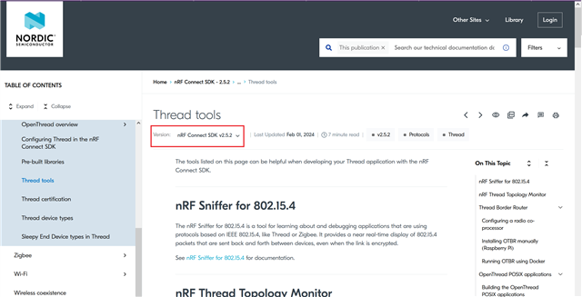

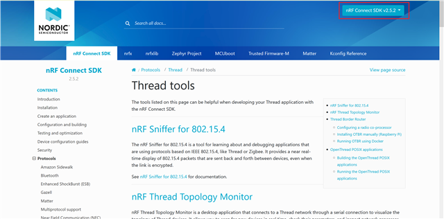

    Which version of nRF Connect SDK are you using? I see that you mention commit 1813352 in your text, which is the commit used in nRF Connect SDK v2.1.0. If you are using a newer version of the SDK this might explain the problem. In v2.4 and v2.5 you should use commit 9185bda.
    You can see which version of the documentation you are viewing at the top right corner of the page:
    Or if you are using the new TechDocs you can see it directly under the title of the page:
