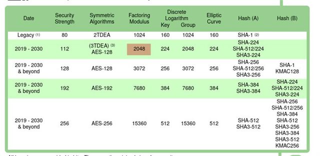

    The key-length of 1536 is not recommended for anything than legacy implementations according to NIST recommendations (and others):
    RSA key size of 2048 and larger is recommended as usable until 2030, with SHA-2 (224 or larger). The reasoning is that the security strength of the operation is so low that it is difficult to give guarantees that it won't be broken. https://www.keylength.com/en/4/
