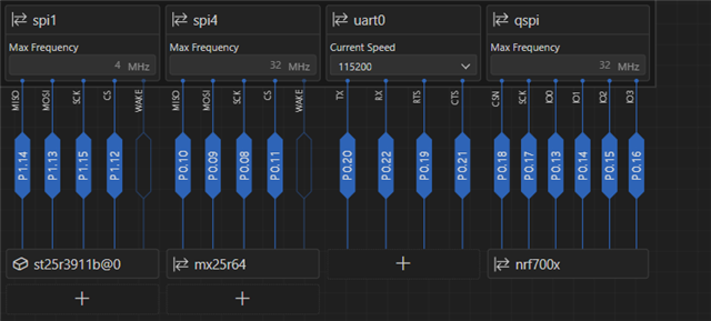

I am working on the 7002DK, and it seems the external flash is working as expected:
[00:00:00.290,740] <inf> spi_nor: mx25r6435f@0: 8 MiBy flash
Though when I add the DFU, I get these errors
C:/ncs/v2.5.0/zephyr/drivers/flash/nrf_qspi_nor.c:69:2: error: #error "No size specified. 'size' or 'size-in-bytes' must be set"
69 | #error "No size specified. 'size' or 'size-in-bytes' must be set"
and
Could not find memory mapped address for XIP. Generated update hex files
will not have the correct base address. Hence they can not be programmed
directly to the external flash.
Am I missing some configs? Should I add a memory partions, if yes do you have an example?
