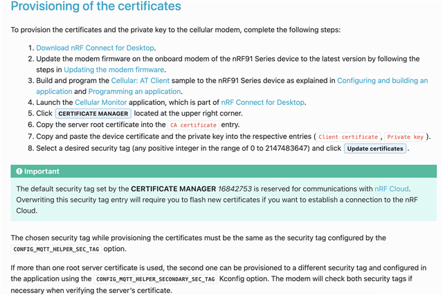

In terms of my CA certificate, I created it using SSL and had it signed. It was also correctly verified on my Azure IoT Hub:
If anyone could provide guidance on how to correctly fix this issue or point me towards relevant documentation or examples? Your help would be greatly appreciated! Thank you so much.
  • Hi Amanda,
    Thank you for replying! I looked into the doc before and this was the only thing I could find for provisioning certificates to the board:
    The issue is that I cannot do this with the nRF7002DK.
