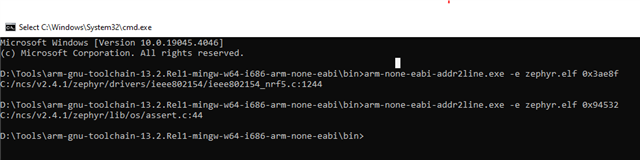

uart:~$ E: IPC endpoint bind timed out
ASSERTION FAIL @ WEST_TOPDIR/zephyr/drivers/ieee802154/ieee802154_nrf5.c:1244
E: r0/a1:  0x00000004  r1/a2:  0x000004dc  r2/a3:  0x2000e340
E: r3/a4:  0x200192a4 r12/ip:  0x00000000 r14/lr:  0x000354fb
E:  xpsr:  0x69100000
E: s[ 0]:  0x00000000  s[ 1]:  0x00000000  s[ 2]:  0x00000000  s[ 3]:  0x00000000
E: s[ 4]:  0x00000000  s[ 5]:  0x00000000  s[ 6]:  0x00000000  s[ 7]:  0x00000000
E: s[ 8]:  0x00000000  s[ 9]:  0x00000000  s[10]:  0x00000000  s[11]:  0x00000000
E: s[12]:  0x00000000  s[13]:  0x00000000  s[14]:  0x00000000  s[15]:  0x00000000
E: fpscr:  0x000b81e0
E: Faulting instruction address (r15/pc): 0x00085e90
E: >>> ZEPHYR FATAL ERROR 4: Kernel panic on CPU 0
E: Current thread: 0x2000e340 (main)
E: Halting system
Is there any way to resolve this issue?
