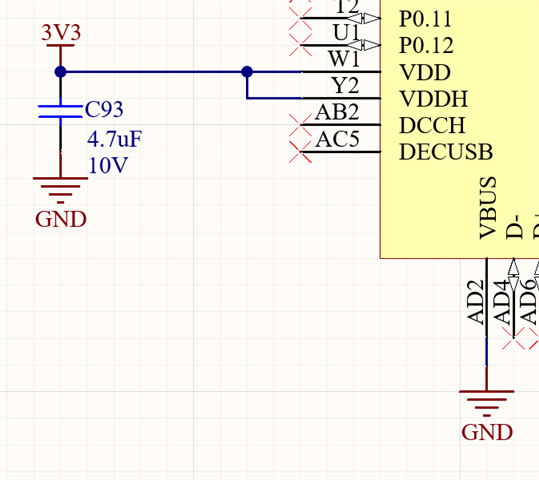

Dear community,
Somes mistake have been done on a production.
DCCH pin have pin connected at VDD instead of of VDDH.
I'm in "Normal Voltage mode, DC/DC REG1 enabled" with code configuration :
NRF_POWER->DCDCEN = 1;
I know that is wrong.. but do you think i i have a chance to have a functionnal board ?
