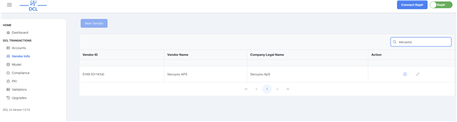

We have read about 'Storing Certification Declaration in firmware' and we have also read case ID: 309896.
However it is not clear to us where we need to store the certificate for production purposes.
We would prefer to store the certificate in Zephyr.
Thanks.

    We are also listed in the DCL. You can check yourself.
    Jenzo said:
    Subject: CN = Mvid:141D Mpid:0111
    I checked your DCL listing and saw that the hex ID for PID is 0x6f and the decimal number is 0111. You list your VID in the hex format, so please ensure that the PID is also in a hex format.
    Also, regarding testing with a Matter controller: we can help you most when you test your device with the chip-tool. Please test with the chip-tool and provide logs to us if you have any issues.
    edit: I wrote VID for your PID, sorry about that. Fixed it.
