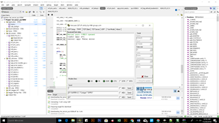

  • I am running the code of twi sensor, where I have added the adxl part,
    here is the code of main

    it will print A=1
    then comes a fatal error, here is the screen shot
    Help me in this, Thanks

  • OK, are you able to capture a logic trace of the SDA and SCL lines going to the ADXL345 ?
