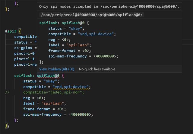

Yet another Zephyr DeviceTree problem; this time with SPI spi-max-frequency (amongst others)
My question is:  why are XX_frame_format, XX_duplex, and XX_spi_max_frequency #defines not being generated in devicetree_generated.h??
Here's the .dts snippet for &spi3:
&spi3 {
    status = "okay";
    cs-gpios = <&gpio0 19 GPIO_ACTIVE_LOW>;  // Memory CS
    pinctrl-0 = <&spi3_default>;
    pinctrl-1 = <&spi3_sleep>;
    spiflash: spiflash@0 {
        status = "okay";
        compatible = "spi-device";
        reg = <0>;
        label = "spiFlash";
        frame-format = <0>;
        spi-max-frequency = <40000000>;
Note that both frame-format and spi-max-frequency are specified.
But when I build I get errors for the following line:
#define SPI_OP  (SPI_OP_MODE_MASTER | SPI_MODE_GET(0) | SPI_WORD_SET(8) | SPI_LINES_SINGLE)
const struct spi_dt_spec spiFlashDt = SPI_DT_SPEC_GET(DT_NODELABEL(spiflash), SPI_OP, 0);
Specifically, complaints about XX_spi_max_frequency and XX_frame_format and XX_duplex not being defined in devicetree_generated.h

And I agree with the error - XX_spi_max_frequency and XX_frame_format and XX_duplex are not in devicetree_generated.h.  My question is why?

  • I think maybe you may need to define a vendor. Does it work if you do "vnd,spi-device"?
  • Interestingly, that's what I started with based on an example I found online, but VS Code kept giving me the following error:
    And that error went away when I changed "vnd,spi-device" to "spi-device".  Based on your suggestion went back to "vnd,spi-device", ignored the VS Code error, did a rebuild, and voila, devicetree_generated.h now has all the #defined attributes that I need.  So I guess I'll just live with (and ignore) the VS Code complaints.
