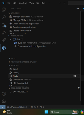

there is a device showing in the connected devices tab.

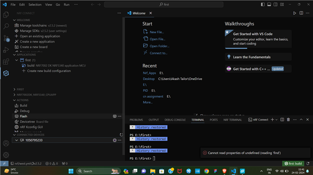

but when I click the expand button to see details, it does not show and says " cannot read properties of undefined (reading 'find')
I can't flash the code to the board until the details show.
I need help with the connected device is showing but when expanding it to view details, it's giving an error.  " cannot read properties of undefined (reading 'find')

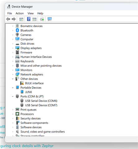

  • I am attaching the device manager screenshot.
    It's showing a USB Serial Device in COM6 and COM7. I have only connected one Device that is nRF7002DK in one port only.

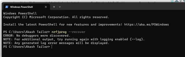

    I have tried recovering the device using nrfjprog --recover, but also shows an error, no Debuggers Were discovered.
    I am a beginner, please guide me on what driver or software needed to install although I have installed everything mentioned in the steps I followed in installing.
