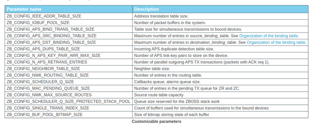

I am looking for clarification regarding that small note [Developing with ZBOSS]:
The memory configuration must not be changed between firmware versions if the firmware is going to be upgraded using the OTA DFU.
  1. Is it valid for all configs or only for part of them ?
  2. How this works under the hood ?
  3. Is OTA incompatibility still valid if I am using static partition layout ?
  4. Do I really need to put my custom memory configuration header after zboss_api.h everywhere I am using the zboss_api.h ? Can it be done in other way in Cmake for eg. ?
I look forward to hearing from you,
Pawel
  • Hi Maria,
    Thank you for your effort.
    This note is not relevant for RAM memory configuration and the note will be removed in a future documentation update.
    So since today, that note is false-positive and each config (see screenshot below) can be changed between FOTA updates without a risk, am I right?

  • Hi Pawel,
    Note that the Flash memory configuration is still important and will cause incompatibility if they differ between current and new image.
    But yes, the memory configuration for RAM can be changed between FOTA updates.

  • Hi Maria,
    Ok, to sum things up.
    ZBOSS 3.11.2.1 RAM -> These configs can be changed between FOTA/DFU updates.
    ZBOSS 3.11.2.1 FLASH -> That data cannot be changed between FOTA/DFU updates but I do not see any configurable configs. I assume the "Flash memory configuration" applies only to the flash layout. Is my assumption correct?
    Pawel
  • Good summary.
    Yes, you are correct.
    Maria
