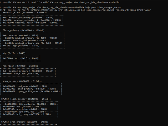

    Alex_S@Aperia said:
    1. Partition manager report:
    This looks fine

    Alex_S@Aperia said:
    default_driver_kconfig: CONFIG_NORDIC_QSPI_NOR <----------------------
    QSPI is the default configuration for all nRF DKs when it comes to external flash with the exception of nRF91DKs and it is chosen when you add your external flash device. The overlay file in the serial_lte_modem, https://github.com/nrfconnect/sdk-nrf/blob/v2.5.1/applications/serial_lte_modem/boards/nrf9160dk_nrf9160_ns.overlay, showcases how to add external flash over SPI and not QSPI
    To summarize: I think what may be causing most of the issues is the external flash device setup, so I suggest we focus on making sure this device is properly setup over SPI before we move on to debugging the rest
