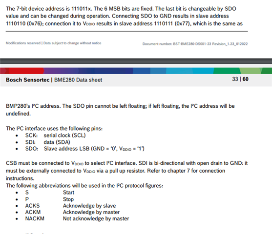

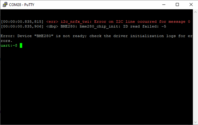

I am doing BME280 sample Application test with nrf connect SDK v2.5.2 but when I am flashing the code, In serial terminal (Putty) I am facing issue Device BME280 is not ready; check the driver Initialization logs for errors and chip_id read failed: -5 and I am facing one warning missing dependencies in .config file DT_HAS_BOSCH_BME280_ENABLED it is enabled and in .prj config file when iam enabling CONFIG_BME280 but at build time it is showing n and missing dependencies warning. So, can you please, help me through it.
I have added .Overlay file as mentioned below.
&i2c0 {
	compatible = "nordic,nrf-twi";
	status = "okay";
	bme280@76 {
		compatible = "bosch,bme280";
		status = "okay";
		label = "BME280";
		reg = <0x76>;
and I have added.prj file as mentioned below.

and In putty serial terminal Iam getting error like this. So, can you please, help me through this.
