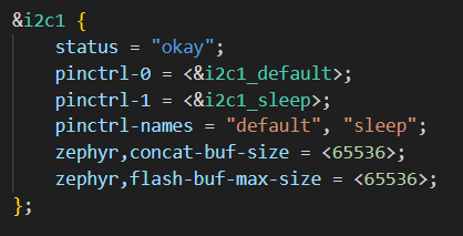

I have a sensor device over i2c that I am communicating with. This device’s driver needs to send 32k data chunks over i2c. Since the data needing to be sent is stored in ROM, I modified the device tree’s zephyr,concat-buf-size and zephyr,flash-buf-max-size to be 64kB in the i2c instance to allocate the data in RAM during sending. The full max size that I thought was supported was 64kB (uint16_t max), as per the i2c_nrfx_twim_config struct’s msg_buf_size config variable used in i2c_nrfx_twim_transfer()
During the i2c transfers of the 32k writes, I am now getting the error message “<err> i2c_nrfx_twim: Need to use the internal driver buffer but its size is insufficient (2 + 32768 > 2048). Adjust the zephyr,concat-buf-size or zephyr,flash-buf-max-size property (the one with greater value) in the "i2c@40004000" node.”, showing that the i2c max size is only at 2k, and that im trying to send just over 32k. My questions are:
  1. Why do the device tree changes (64k) only allow the buffer size to go to 2k? See devicetree screenshot:
  2. Is the true max size 64k? I have seen other places on the Nordic forums saying it was anything from 255 Bytes to 64kB?
    A uint16_t can't hold the number 65536, it can only hold numbers from 0 to 65535. Can you check if reducing it by 1 makes any difference? If this does not work, please check that the overlay is actually being applied to the build (you can check the generated devicetree in build/zephyr/zephyr.dts).

  • My mistake! Of course, was my error; range 0-65535. I assumed the .dts field zephyr,concat-buf-size/zephyr,flash-buf-max-size "size" was a size, but its more of a "max value".
    Great reference for the max supported link, thank you.
    Large transfers (~32k) are working for me now, thanks.
