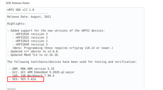

SEGGER Embedded studio version to use with nRF5 SDK v17.*?
Ambiguous information about SES version to be used in Nordic documentation: mentioned install the most recent release … or Embedded Studio for ARM (version 3.30 or later).
Currently most recent version ES for ARM that Segger offers is V7.32a, but is marked as (legacy)
While there is a newer version ES V8.10b (that supports and ARM). I already asked Segger support, but the forward me back to Nordic support, so my question will be which version to use for developing with nRF5 SDK v17.*?   If it is ES V8.10b – is the free commercial license for developments with nRF still valid with it?
 SES versions as of Feb24
