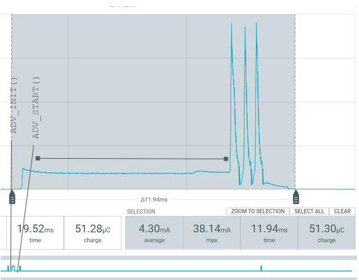

Screenshots taken using the very good Nordic power profiler kit are instructive. The current consumption is depicted along time axis, nicely showing the chip activity and the 3 advertising packets (one on each RF advertising channel, 37, 38 and 39). The debug pulses are visible on the bottom of the screenshot In this first screenshot, one can see that once advertising_start() is called, it takes about 10 ms for the packet to start. :

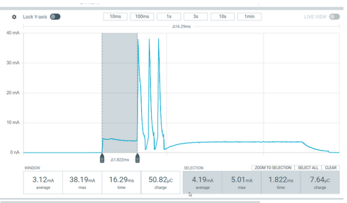

The 2nd screenshot is taken after the system has run on its own for maybe one minute or two. The very same code is running. Here one can see that the effective packet transmission is starting only 1.8 ms after entering in my function. So the long "tail" of waiting after the packet has been transmitted is here pure waste of time and DC power:
These 2 measurements show that the startup time of the stack seems very variable for whatever reason. I've also seen packets being transmitted so late that the last advertisement transmission was cut-out by the advertisement_stop() command and not transmitted at all. IN some cases the last packet was "damaged". Obviously the stack can startup in 1.8 ms, but for some reasons, it doesn't do it always so fast. In some cases it takes up to 10 ms to start. Why?

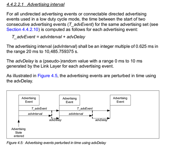

    The Bluetooth specification requires a random 0 ms to 10 ms delay to be added prior to every advertising event. This is to prevent scenarios where your advertising may become synchronized with advertisement events from other nearby advertisers.
