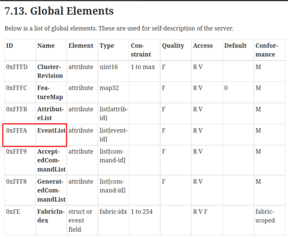

BTW, when I read the event-list attribute of the ICD management cluster, I always encounter the error "UNSUPPORTED_ATTRIBUTE", even though I have confirmed that I have checked it in ZAP. Could you please advise on how to resolve this problem?

hoorii-zzy said:, when I read the event-list attribute of the ICD management cluster
Do you see this in the window management sample?
Yes, window-app example is the same error.
Could you post the command that you use when the error occurs?
Then I can check if this is a bug or not.
./chip-tool icdmanagement read event-list 1 0
What is the result of the verification? I hope you can please reply to me and provide a solution as soon as possible.
Yours,
Jerry
What happens if you try the following command?
./chip-tool icdmanagement read attribute-list 1 0
The log is :
0xfffa is missing from your list of supported attributes.
This is the reason to why event-list fails
