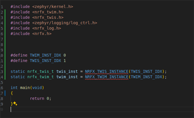

2. But i want to use it completely on nrf hal.That's my code(its not actually a code, i just want to somehow enable it)

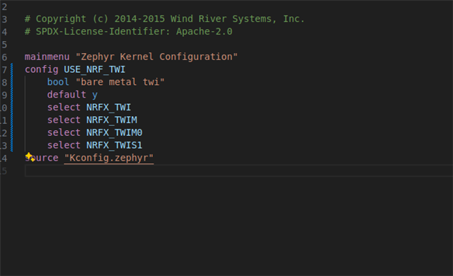

2. Ive tried various KCONFIG options
CONFIG_NRFX_TWI0=y and so on, with turning off all the peripherals with same address.
it didnt work, i always had error CONFIG_NRFX_TWIM0 was assigned the value y, but got the value n. Missing dependencies:
n
and ofc, i couldnt enable it with Kconfig GUI.
So ive set sth like this:
and thats my error:
Im using nrf connect app to make projects, it might be an issue i guess. The question is what should i do to make i2c0 status = okay(TWIM) in HAL/Kconfig way
