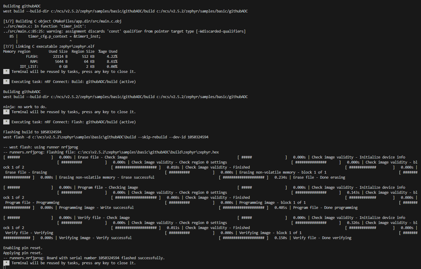

    I copied and pasted your code from main.c into the main.c file of the 'hello_world' sample, and added the following Kconfig settings to prj.conf:
    CONFIG_NRFX_TIMER1=y
    CONFIG_NRFX_SAADC=y
    CONFIG_NRFX_PPI=y
    After doing this, the code compiled without errors. Could you please try the same? I used SDK v2.5.2 and built for the 'nrf52840dk_nrf52840' board.
    Vidar

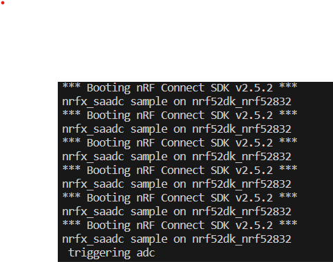

  • Hi Vidar,
    Thank you for the help, I was able to build and flash the code without any errors in the console however squiggles in the vscode did not disappear hopefully some intellisense issue. Anyhow when I connect to the serial port I do not see any messages or output printed in the console.
    Any idea or help on why there is no output in the console of serial port? Even the main() --> printk is not outputted in the serial port. Kindly feel free to advise if I am missing something as I am still learning this environment.
    Regards

  • Hi Srinidhi,
    Relevant warnings and errors will be displayed in the build output. Any other warnings reported by intellisense can be safely ignored. Regarding the missing log output, are you using the DK? And, have you successfully received console output from other examples with your setup? I did not experience any logging problems when I ran the code on my end.
    Hex file from my build if you want to test it:
    0081.zephyr.hex
  • Thanks for the hex file Vidar, however even after flashing the hex file I couldn't see any log outputs. I tried the sample blinky application and I am able to see the log output(VCOM0). I even tried adc from zephyr drivers and I successfully received the log outputs.
    Only the current application is having these issues. If you are able to log output then am I missing something? I used serial terminal from vscode as well as the nrf connect desktop tool to test the logging.
    I tried most ways possible, kindly guide me to resolve this issue.
  • Apologies, I was testing with the nRF52840 DK, which explains why my .hex file would not run on your 52832 board. Are you using the nRF52 DK?
    SAADC sample built for nrf52dk_nrf52832
    3750.zephyr.hex
    Programming the hex with nrfjprog
    $ nrfjprog --program zephyr.hex --chiperase --verify --reset
    Project
    8540.nrfx_saadc.zip

        err = nrfx_saadc_init(IRQ_PRIO_LOWEST); //ERROR identifier "IRQ_PRIO_LOWEST" is undefined
        if(err != NRFX_SUCCESS)
            LOG_ERR("Error! Could not initialize SAADC: %d\n", err);
        err = nrfx_saadc_offset_calibrate(NULL);
            LOG_ERR("Error! Could not calibrate offset: %d\n", err);
        err = nrfx_saadc_channel_config(&saadc_channel);
            LOG_ERR("Error! Could not configure SAADC channels: %d\n", err);
        err = nrfx_saadc_advanced_mode_set((1 << SAADC_CHANNEL_NUM), NRF_SAADC_RESOLUTION_10BIT, &saadc_adv_cfg, saadc_evt_handler);
        //err = nrfx_saadc_buffer_set(&samples[next_free_buf_index()][0], SAADC_BUF_SIZE);
            LOG_ERR("Error! Could not set advanced SAADC mode: %d\n", err);
        err = nrfx_saadc_buffer_set(saadc_buf1, SAMPLES_IN_BUFFER);
        // err= nrfx_saadc_buffer_set(&samples[next_free_buf_index()][0], SAADC_BUF_SIZE);
            LOG_ERR("Error! Could not set buffer1: %d\n", err);
        //err = nrfx_saadc_buffer_set(saadc_buf2, SAMPLES_IN_BUFFER);
            LOG_ERR("Error! Could not set buffer2: %d\n", err);
        printk(" triggering adc \n");
        err = nrfx_saadc_mode_trigger();
            LOG_ERR("Error! Could trigger mode: %d\n", err);
        printk(" inited ADC\n");
    int main()
        printk("nrfx_saadc sample on %s\n", CONFIG_BOARD); //ERROR printk identifier undefined - surprisingly printk other than main() has no error
        nrfx_err_t err;
        saadc_init();
        printk(" looping \n");
        while(1)
    OUTPUT
  • The sample is already set up to perform sampling in the background. Each sampling task is triggered in the background by TIMER events.
