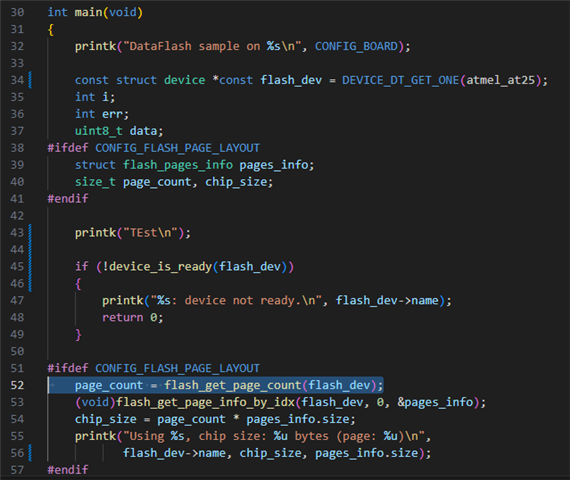

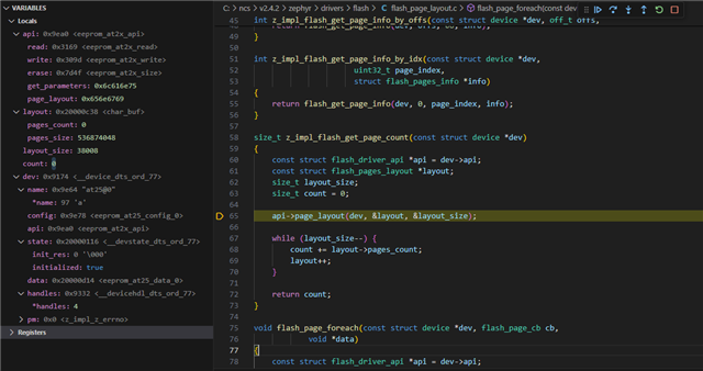

    I checked with the debugger: starting from the Sample at45 main method, the highlighted line gives the error:
    To be more precise, the error occurs inside z_impl_flash_get_page_count() in flash_page_layout.c.
    The line
    api->page_layout(dev, &layout, &layout_size);
    triggers the error, meaning the MCU resets when executing it.

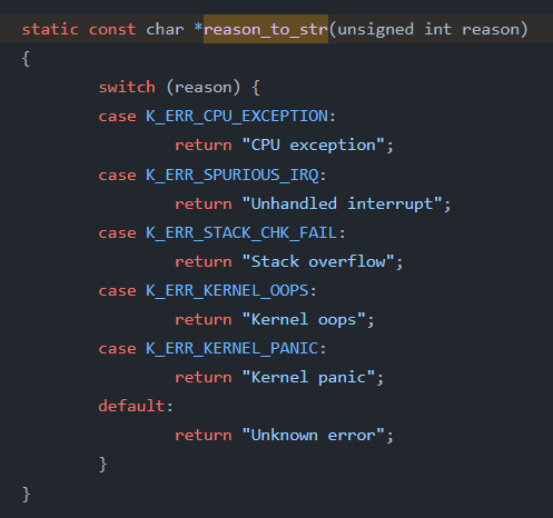

    The "unknown error" comes from this code in the zephyr fatal.c file:
    Being a run time error would suggest that the configuration of the EEPROM is correct, but the software is attempting to do something illegal.

  • To add more context, this is the situation before crashing:
    Going into the definition of page_layout, I see that it needs CONFIG_FLASH_PAGE_LAYOUT=y, which I confirmed is enabled by default with my proj.config, which so far looks like:
