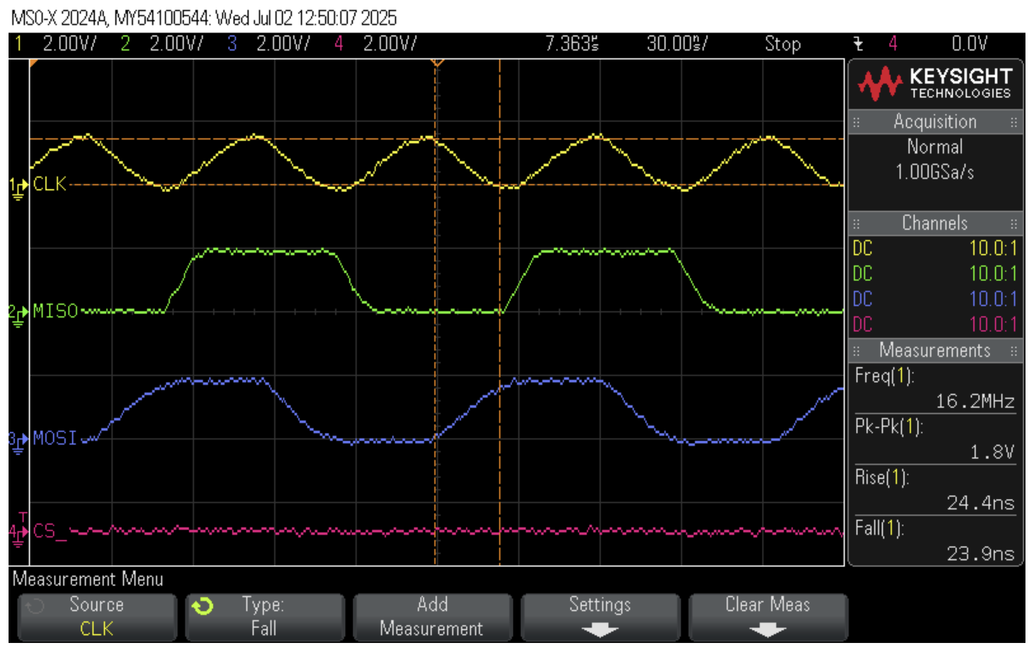

The limitation for using several SPI slaves with high-speed SPI is not so much the CSN but rather the load on the SCK, MISO and MOSI pins. Each additional SPI slave with its PCB routing will add capacitive load and affect the waveforms.

Hello, I have a follow up question. Is there a max or recommended capacitance for the HS SPI interface?
We are noticing poor waveforms when using the HS SPI interface at 16 MHz.
