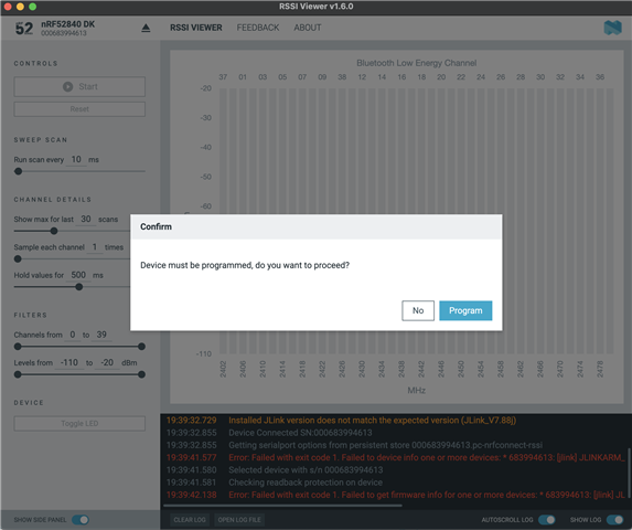

I need help with my Nordic nrf52840DK board. Its is now failing to connect with the latest NRF Connect Desktop v4.4.0
I plug the board into the USB port of my macbook pro (MacOS BigSur v11.7.0) and the RSSI desktop app sees the jlink serial number but there's always an error that says failed to open device. and I tried to match what the NRF Connect version wants (it's looking for 7.88j) but there's only version 7.88n that is downloadable and upgrading to that version doesn't work either and fails the same.

    Did you use RSSI Viewer application from nRF Connect for Desktop? Have you tried programming the device when prompted to do so?
    Dejan
  • I tried to use RSSI Viewer but failed to do so and yes I tried to program the device when prompted but that also failed even though the serial number is "seen" but NRF connect fails to open the connectivity to my 52840DK...... I also tried drag and dropping the OB bin file from Segger for the Nordic 52840DK board but after that the same failures still occur
  • I dug up my old windows PC notebook w/ Win10, and an older installation of NRF Connect desktop the BLE app was v4.0.1,... it recognized my nrf52840dk board ... and I was able to program it .... the good news is that when I plugged the dk board back onto my newer macOS NRF Connect desktop (v4.4.0)... the BLE app also successfully found the dk board and programmed it and can now scan BLE
