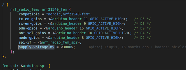

When I try to build the project I get the following errors (see screenshot) -->
Can you please tell me what this has to do with?
