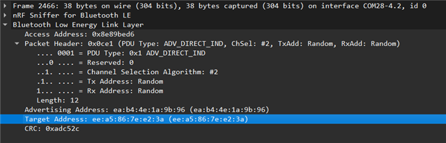

    I have directed advertising working fine without an IRK. Without IRK, my code is as follows:
    // Start advertising
    ble_advertising_start(&m_advertising, BLE_ADV_MODE_DIRECTED);
    This results in event BLE_ADV_EVT_PEER_ADDR_REQUEST
    case BLE_ADV_EVT_PEER_ADDR_REQUEST:
       // This event occurs when directed advertising is used
       Log(BLE, "BLE_ADV_EVT_PEER_ADDR_REQUEST");
       ret_code_t retCode;
       uint8_t mac[BLE_GAP_ADDR_LEN] = {0xEE, 0xA5, 0x86, 0x7E, 0xE2, 0x3A};
       ble_gap_addr_t peerAddr;
       // Set GAP structure
       peerAddr.addr_id_peer = 0;
       peerAddr.addr_type = BLE_GAP_ADDR_TYPE_RANDOM_STATIC;
       // Copy in MAC but reverse byte order to match GAP address type
       rev_memcpy(peerAddr.addr, mac, sizeof(peerAddr.addr));
       retCode = ble_advertising_peer_addr_reply(&m_advertising, &peerAddr);
       APP_ERROR_CHECK(retCode);
    Edit: Here is a Wireshark capture of my working directed advertising with a random static address (No IRK).
