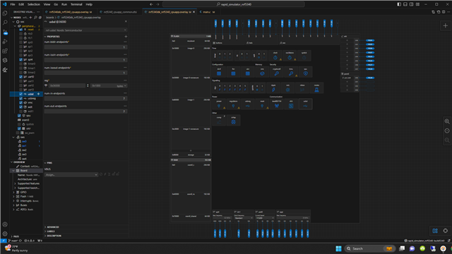

  • This pin is selected by uart1 in the 5340DK's pin control file. You could disable uart1 and/or change the pinctrl definitions for uart1.
    EDIT: to your second question, you could use our visual devicetree viewer or otherwise check the definitions under "zephyr/boards/arm/<YOUR_BOARD>" to see what pins are being used in pin control.
  • visual devicetree is a great idea I hadn't thought of... I checked and uart1 isn't enabled. If I follow the overlapping assignment link in my overlay file I come to: gpio_fwd: nrf-gpio-forwarder.
    I disabled that with the following. It removed the overlapping pin warning, but it didn't improve p1.00.
        gpio_fwd: nrf-gpio-forwarder {
            compatible = "nordic,nrf-gpio-forwarder";
            uart {
                status = "disabled";
                gpios = <&gpio1 1 0>, <&gpio1 0 0>, <&gpio0 11 0>, <&gpio0 10 0>;

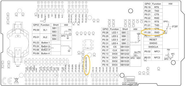

    If you flip the kit around, you will see which GPIOs goes where, for instance LEDs/buttons and UART connections towards the SEGGER On-board-debugger.
    P1.00 is RXD and is physically connected to the SEGGER OBD, and it will be pulled high by that chip, so if you're pulling it low; it will effectively be output vs output (a short).
    Håkon
  • Thanks! I didn't realize there was information on the backside of the pcb! :) I found a hw drawing of it. I see the RXD-P1.00 connection, but I don't see the SEGGER OBD-P1.00 connection, so that is good to know. Is there another drawing that shows SEGGER connections? Or am I missing something?
    I think you'll need to look at the schematic for the DK to see the actual traces/connections, but there are certain pins that are dedicated to USB/UART connections between the nRF and SEGGER OBD, which will cause problems if you try to ground.
    The pins marked with "RTS/CTS/RXD/TXD" are directly connected to the on-board-debugger. Depending on the type of kit, there can be between 1 and 3 instances. For the nRF5340, there's two; one for app core and one for net core.
