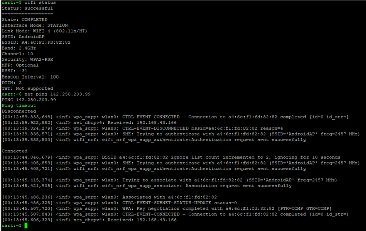

I have implemented the nrf firmware example "Wi-Fi Shell" on the nrf7002 development kit.

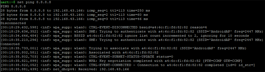

But I noticed a strange behaviour, after a while I cannot ping any server and it disconnects and reconnects from the access point.
It always gives the error reason=4 for the disconnection:
CTRL-EVENT-DISCONNECTED bssid=a4:6c:f1:fd:82:82 reason=4
Now as I understand it, reason 4 means "disconnected due to inactivity".
Is this conclusion correct is there any documentation about the error and how can I fix this problem so that it does not happen again?
