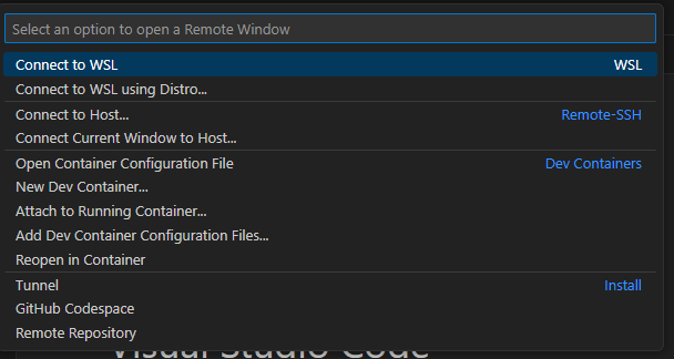

  • I can execute tests by flashing them to nrf9160dk. I am wondering if im using windows is this my only option? Is there a way to use native_posix, native_sim or qemu cortex_m3 simulation layers in windows. This would speed up the test process alot.
    Thanks in advance.
  • Interesting, it was new to my also, I do run ubuntu on my computer so that might be why I did not see it. In a previous company we used ceedling( test suite from the makers of Cmock and Unity). We used WSL as a build environment for our testing and it worked like a charm. If you install windows subsystem for linux you can setup VScode to use it as a remote window. The downside to this is that you will need to install our SDK for WSL also.
    Regards
    Runar
  • Good that you were able to run the test. Please see my other response regarding using WSL. In general you don't want to run unit tests on target for multiple reasons
    Just some examples
    1. It takes time to flash the device
    2. The code is suddenly no longer hardware independent
    3. Can't be integrated into a CI pipeline
    Regards
    Runar
  • Thank you for great response.
    I have wsl installed, I try to make this work with wsl.
    This comment really helped a lot.
    Final question: does nordic have tutorial/guide how to set up sdk with wsl?
