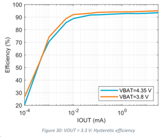

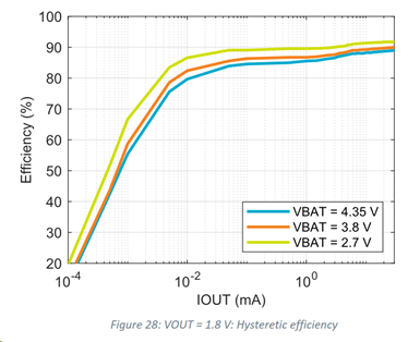

We received directly from Nordic samples of the nPM1300 revision C.
We are aware that according to the errata, the efficiencies of BUCK1 and BUCK2 should be 10% less than expected from the datasheet.
We measure the efficiencies and we got 15% less for the BUCK1 (1V8 output) and 20% less for the BUCK2 (3V3 output):
VBAT_IN
I(vbat_in)
P(vbat_in)
Vout
Iout
Pout
Efficiency
4.35V
5.70mA
24.79mW
1.8V
10mA
18mW
72.6%
3.8V
6.26mA
23.8mW
1.8V
10mA
18mW
75.6%
VBAT_IN
I(vbat_in)
P(vbat_in)
Vout
Iout
Pout
Efficiency
4.35V
2.27mA
9.87mW
3.3V
2.2mA
7.2mW
72.9%
3.8V
2.68
10.18mW
3.3V
2.2mA
7.2mW
70.7%
Is it something already known for this revision? Will it be improved? Can you share the setup used for the measurements?
