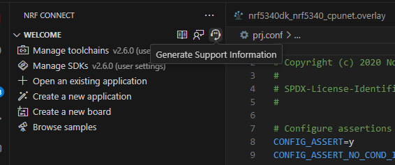

    Could you generate the support information from vscode and post it here?

    Correct, new version of SDK and toolchain. Project with only hellow world and no changes. I am NOT including any file named version in my project folder.
    Here follows the support information generated from vscode:
    IMPORTANT: The data below could contain sensitive or confidential information about your environment.
    If you do not wish this to be seen by others, please make sure to remove it before sharing.

    FATAL ERROR: command exited with status 1: 'C:\ncs\toolchains\cf2149caf2\opt\bin\cmake.EXE' -DWEST_PYTHON=C:/ncs/toolchains/cf2149caf2/opt/bin/python.exe '-Bc:\nrf5340dk_projects\PASTO\hello_world\build' -GNinja -DBOARD=nrf5340dk_nrf5340_cpuapp -DNCS_TOOLCHAIN_VERSION=NONE -DBOARD_ROOT=c:/nrf5340_pasto -DCACHED_CONF_FILE=c:/nrf5340dk_projects/PASTO/hello_world/prj.conf '-Sc:\nrf5340dk_projects\PASTO\hello_world'
    * The terminal process terminated with exit code: 1.
    * Terminal will be reused by tasks, press any key to close it.
