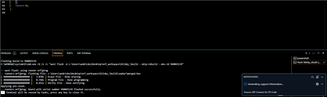

Now on the new laptop I re-installed everything like before following https://developer.nordicsemi.com/nRF_Connect_SDK/doc/latest/nrf/installation/install_ncs.html# this instruction but I upgraded SDK version from 2.5.0 to 2.5.2. Now when I try to launch the nRF Connect debugger it just flashes the nRF9160 dk and does nothing else. In other words the Debug option does exactly the same what the Flash option does. Since I did not want to bother with it in the beginning I just downloaded Ozone and used it, but I'd prefer to use the builtin nRF Connect connect debugger. Did not find any useful workarounds since most of the people that have some debugger issues at least manage to launch the debugging session but my system does not get that far. I checked nRF Connect settings in VS Code and did not find anything about debugger path (for example to use gdb) or anything like that. I haven't tried to downgrade the SDK bersion back to 2.5.0 because I believe that it is not the issue here (maybe will try next week if I have some spare time).

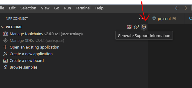

    About the support information, I would give it to you but when I pressed the button "Generate support information" nothing really happens. There is this notification in the bottom right corner saying that the information is generating:
    but its been already 30 minutes and nothing happened. No info in terminal nor a file generated in project folder
  • Hello again,
    Just a heads up. This morning I upgraded SDK and toolchains in VS code to 2.6.0 version and that seems to fix the debugger issue, so I'll close this ticket.
    Also the "Generate support information" button started working. So I guess there was some sort of issues with 2.5.2 version. Anyway thanks for help!
