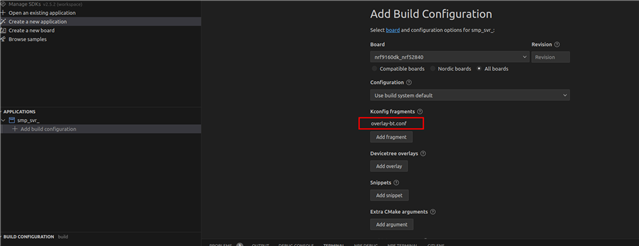

  • Few other things that I have tried since:
    - updated to NCS 2.6.0-rc1
    - sample application BLE Uart Service and added mcuboot
    - nRF Connect App from different Android phone
    - using the nrf9160DK (it's the only DK with nrf52840 that I have handy at the moment)
    - changing the app version number in VERSION file
    All of these resulted in the same issue. The DFU process either exists immediately saying "Application has been sent successfully" when from what I can tell this is not true or it appears to upload, then reboots and hangs when Validation starts.
    Please start a debug session in VS Code. After the program hangs, attempt to pause the debugger to see where the program is hanging. Additionally, you may want to experiment with the smp_srv sample using the Bluetooth overlay:
    This sample should work out-of-the-box and provide a working reference for comparison.

  • Please try the nRF Device manager app and read out the mcuboot slots from the advanced menu. It sounds like the hash for the image present on the device might be identical to the one you are trying to upload.
  • Thanks this is helpful!
    You're right that the file hash is part of the problem. How is it possible that I comment a chunk of code build the app_update.bin that has different file size and different MD5 sum from the previous and yet the hash shown in the nRF Device Manager is the same? I've just double checked this and the hash shown for both .bin files is the same.
    After some attempts (not sure what I did) I was able to get a bin file with different hash and if I do the firmware update process manually within the Device Manager app (that is, in Advanced Mode I first upload, then read, test, reset, confirm and reset ...it seems to work and I can see the slots changing hash. However if I try to do it using the "Basic" process it doesn't work.  I'm still trying things so this might not be all correct.
  • Some more info:
    - it seems there might be a bug in nRF connect app where it the file name doesn't change it keeps loading the same hash value. I was loading the .bin file directly from a Dropbox folder containing the build folder. So I would build, wait for sync and use the .bin file. If I do this, even if the bin file changes (and I can see that from size and date when selecting it) the app keeps showing the old hash and the file not uploaded. Simply renaming the .bin file loads the correct hash.
    - I tried again the manual sequence in Device Manager advanced mode and it works perfectly. If I try the same thing in Basic Mode or in nRF Connect it hangs. I need to dig further into this, but mcuboot itself appears to be working correctly.
  • Some more info:
  • I think I solved the issue!
    In my application main() I had a call to load settings data from NVS and I had placed this before a function that calls bt_enable() and bt_le_adv_start(). I think this was blocking the boot process during the Test mode. Moving the settings load function to after the bt initialization solved the issue.
    I had tested this before but the problem with the hash value not updating was preventing the new firmware from loading and this threw me off course.
