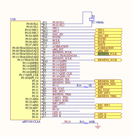

32.768 Crystal routing to P0.10
We need to route P0.00 - P0.01 crystal clock to P0.10
Is there a way to do that?

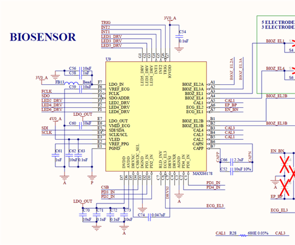

  • Hi, Thanks for the response. MAX86178 needs 32.768Khz for ECG signals. We forgot to add the crystal as shown in this original schematicsMAXREF_106_SCH-4 (1).pdfSIT1572AI-J3-18E-DCC-32.768
    However we have one oscillator at P0.00 - P0.01
    We were thinking if we could use that for the purpose and the the signals. Although there is an internal oscillator inside MAX86178, but using that induces a lot of noise.
    Our schematics below:
    has the F5 (FCLK) connected to P0.10 pin of nrf5340 instead to the external oscillator.
    We hope we could explain the thing.
    Regards
    Vivek
  • Ah, I don't have access to the MAX86178 datasheet (requires NDA).
    Two options:
    1) see if the datasheet allows operation of the AFE from 16.384kHz input clock on F5 FCLK, if so easy fix I can share code.
    2) Try connecting P0.00 to P0.10, naughty but it will (might) probably work well enough for trials. P0.00 is a weak "output" at 32.768kHz exciting the crystal, P0.10 in this case would have to be left as a floating input.
    Edit: Option 3 use a PWM to generate a clock close to 32.768kHz; downside is power consumption since to get good PWM timing accuracy the 32MHz crystal has to be enabled

  • I don't have a tested DPPI option to hand for the nRF5340; here is a tested PPI example for the nRF52832/nRF52840 with a guess at a working nRF5340 DPPI:
