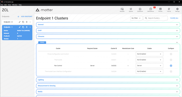

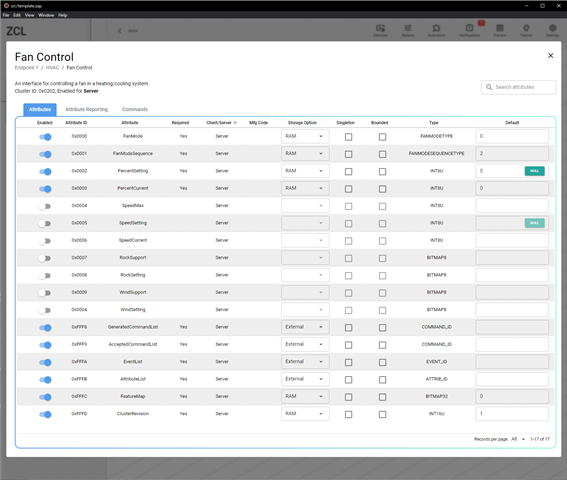

I am implementing Fan Device (provisional) on nRF52840 with Matter over Thread. I implemented Fan Device Endpoint and Cluster with ZAP tool according to Adding clusters to Matter Application. Clusters and Attributes were set as default.
I created zcl_callbacks.cpp and implemented the MatterPostAttributeChangeCallback() function. To check the operation, I added only the code that outputs the log in the function called in app_task.cpp.

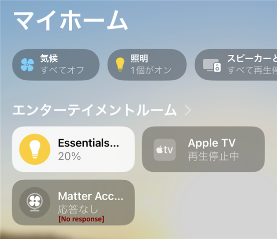

Following the Matter: Template article, I used an iPhone 8 to commission the nRF52840 to a Matter network with an Apple TV 4K configured as a Border Router. This also completed successfully and was recognized as a Fan Device by the iPhone.
However, the Fan Device control does not work properly. When turning on/off or adjusting airflow, the device frequently goes into a "no response" state and does not accept any operations for a certain period of time. Ican switch it on/off after a certain period of time (if you leave it for a certain period of time, it will become "no response" again and you will not be able to switch it. Looking at the logs, it seems that the CASE session is being restarted). The air volume adjustment remains in a "no response" state and is almost impossible to operate.
As a side note, perhaps the entire Matter over Thread network is malfunctioning, but when the Fan Device is "no response" and I operate the Nanoleaf Essentials Bulb that is participating in the Matter network, it also becomes "no response".
When I wrote the Matter: Light bulb sample to the nRF52840 as is and made it work, it did not become "no response" and worked normally.
I can't find the cause by looking at the logs and sources myself. Is it because the Fan Device is provisional that it does not work properly?
How can I resolve this issue?

    Please upload the full application log from the device.
    Are you able to test with the chip-tool to see if you see the same behavior there as with Apple Home?
    Marte
  • Marte-san,
    I have uploaded the logs obtained with J-Link RTT. Please confirm. Device-specific information such as Bluetooth MAC was hidden. I have confirmed that it works normally and sometimes becomes "no response".

    I was able to build chip-tool, but I can't reproduce the behavior because my border router only has an Apple TV 4K, and I didn't understand how to use chip-tool even after reading Working with the CHIP Tool.
    As you mentioned, the issue seems to be that the CASE session must be re-established, causing the device to go offline. After the new session is established, both devices will need time to retrieve subscriptions.
    You can try to change the logging mode to minimal with CONFIG_LOG_MODE_MINIMAL, as that might reduce the impact on the performance.
    Apart from this, everything looks correct, and it could be that the issue is with the Apple controller.
