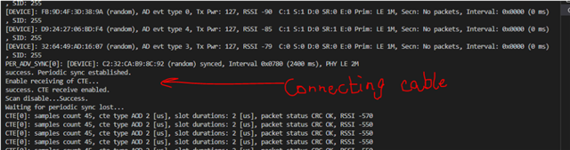

I want to use nfr5340-dk to achieve the transmission and reception of CTE data in low-power Bluetooth AOD mode. I imported the code for wireless transmission and reception in the SDK and configured it according to the example provided on the official website, but I did not successfully receive CTE data. It may be due to some errors in the configuration process. Could you please help me check which step went wrong? During this transmission and reception process, I used two NFR5340-DKs, which come with a built-in Bluetooth antenna. I do not have an external antenna matrix, so is it because my antenna switching mode is wrong? If I don't have an external antenna matrix, how should I configure it? The following are the steps and results of configuring according to the configuration tutorial provided on the official website:

Obviously, it did not receive the CTE data sent by the sender.

    1.Did you encounter my problem when you only used the PCB antenna with two boards instead of using the SWF cable?
    [DEVICE]: 6E:A9:63:DD:76:95 (random), AD evt type 0, Tx Pwr: 127, RSSI -88  C:1 S:1 D:0 SR:0 E:0 Prim: LE 1M, Secn: No packets, Interval: 0x0000 (0 ms), SID: 255
    [DEVICE]: 25:69:F1:44:7C:1E (random), AD evt type 3, Tx Pwr: 127, RSSI -72  C:0 S:0 D:0 SR:0 E:0 Prim: LE 1M, Secn: No packets, Interval: 0x0000 (0 ms), SID: 255
    success. Found periodic advertising.
    Creating Periodic Advertising Sync...ASSERTION FAIL [err == 0] @ WEST_TOPDIR/zephyr/subsys/bluetooth/host/hci_core.c:330
    *** Booting Zephyr OS build v3.3.99-ncs1-1 *** -11
    Starting Connectionless Locator Demo
    Bluetooth initialization...failed (err -11)
    success
    Scan callbacks register...success.
    Periodic Advertising callbacks register...success.
    Start scanning...failed (err -11)
    Waiting for periodic advertising...
    2.If I use AOD mode, do I only need to connect the antenna array with SWF cable at the trasmitting end, and the receiving end only needs to use PCB antenna to create synchronization, and then the receiving end can access CTE data?

  • xu shengxian said:
    using my previous configuration, and connecting an antenna array to nrf5340dk through a UFL connector and configuring antenna switching mode can successfully achieve synchronization and receive CTE data?
    Yes, using the correct antenna connector in J1 is what is stopping you from getting a connection there. Though as Paal in the chat here pointed out, I was wrong in calling it UFL, its SWF.
    If you are struggling with the same thing as the customer in the thread you are linking to, then the antenna connector is what is stopping you.
    I got the error that it doesn't sync and receive anything. Though I do not think I got err-11.
    Yeah that sounds correct. For more info on Direction finding, I would recommend having a look at our whitepaper on it.
