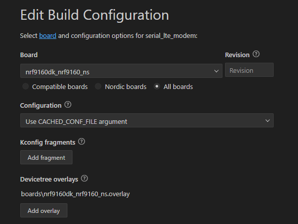

  • Hi Team,
    I have looked at the terminal output in visual studio and it shows the FATAL error. What am I missing anything?
    I am able to build 'blinky' sample code successfully but getting FATAL error when I have build the 'serial_lte_modem' sample code. Can you please guide me to build successfully.

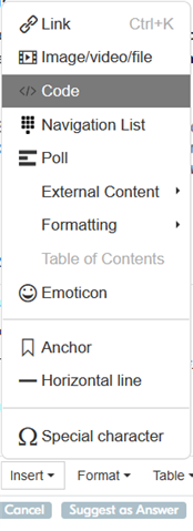

    Would you be able to share the full build log? We recommend using the Insert->Code functionality for readability.

  • Yes, it is unmodified version of serial_lte_modem.
    Build log:
    Executing task: nRF Connect: Build: serial_lte_modem_sample/build (active)
    Building serial_lte_modem_sample
    C:\WINDOWS\system32\cmd.exe /d /s /c "west build --build-dir c:/Sravan/Programs/GIT_Repository/CL5G/serial_lte_modem_sample/build c:/Sravan/Programs/GIT_Repository/CL5G/serial_lte_modem_sample"

    C:/Sravan/Programs/GIT_Repository/CL5G/CL_R200/zephyr/include/zephyr/toolchain/gcc.h:81:36: error: static assertion failed: "Wake up pin not configured"
    81 | #define BUILD_ASSERT(EXPR, MSG...) _Static_assert(EXPR, "" MSG)
    ../src/main.c:49:1: note: in expansion of macro 'BUILD_ASSERT'
    49 | BUILD_ASSERT(CONFIG_SLM_WAKEUP_PIN >= 0, "Wake up pin not configured");

  • Have you selected nrf9160_nrf9160_ns your builld target? Or are you building for a custom board?
    This looks like where the build starts to fail:
  • Yes, I am using nRF9160dk_nRF9160_ns while build target. What is your suggestion to resolve this.
    Please see the configuration options for serial_lte_modem. What happens if you set CONFIG_SLM_POWER_PIN before you build? Possibly like this: CONFIG_SLM_POWER_PIN=P0.30.
    As an alternative, could you try downloading and building using nRF Connect SDK v2.6.0 and see if you have any more luck?
