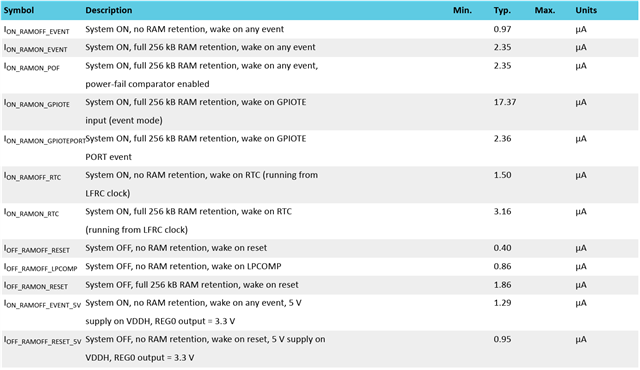

    I want to reduce the current consumtion from 150 uA, for which I was going through the datasheet
    I could see different sleep modes for the nRF52840 board, how do I enable them?
    Could you please provide me some reference to this? or suggest me a example code releted to enabling these sleep modes?
  • As I mentionned before, the CPU will sleep by default as long as you don't do anything. But if any peripherals etc are enabled, they will continue to be. What do you use in your application? A typical problem is UART if you have logging enabled. So the first thing you should make sure is to disable logging, by adding configs like these:
    CONFIG_CONSOLE=n
    CONFIG_UART_CONSOLE=n
    CONFIG_SERIAL=n
    CONFIG_LOG=n
