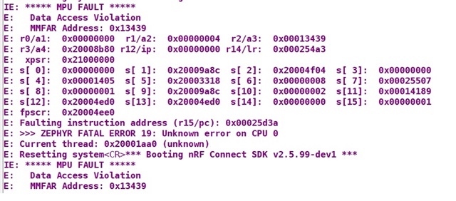

MPU FAULT occurs when creating a new thread
Good Day.
I get an MPU FAULT when creating a new thread where I want to display the RSSI value.
Looking at similar requests in the community, there were recommendations to increase CONFIG_MAIN_STACK_SIZE, I increased this parameter to 2048, but it didn't help.
I have one thread (Priority = 7) in my program now (taken from the BLE example), it sends data over bluetooth.

When adding a second thread (Priority = 8) that should read RSSI, an error occurs.
void rssi_thread(void)
	int8_t rssi = 0xFF;
	while(1){
		read_conn_rssi(default_conn_handle, &rssi);
		LOG_INF("RSSI level = %d\n", rssi);
		k_msleep(1000);
K_THREAD_DEFINE(rssi_thread_id, 2048, rssi_thread, NULL, NULL, NULL, 8, 0, 0);
If I move all the code from rssi_thread() to main(), everything works without errors.
Can you please tell me what could be the reason?
