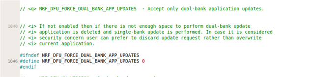

    Most of things are working now, decryption and flashing etc... but I have one additional question about max app size. Bootloader is configured to use dual bank, but in case that someday application won't fit in memory for dual bank I'm expecting to perform update using a single bank.
    Now I'm wondering if this is done automatically, or is there need to update bootloader in case that application won't fit anymore? I found some posts which are quite old (post1, post2)

    It's good to hear that things are working now. Regarding your question about dual and single bank updates, the bootloader will automatically perform a single bank update if the app is too large to fit in bank 1 as long as you have not enabled this configuration setting in your bootloader:
    Vidar
