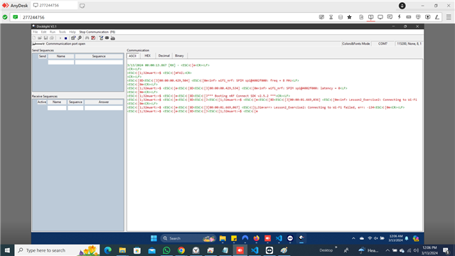

I am trying to connect with static SSID & password to connect with the wififund_less2_exer2_solution
Ncs 2.5.2 and vscode studio , Dk's are nrf52840Dk with nrf7002EK

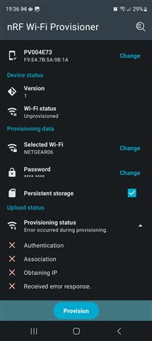

I also tried wifi_provisioning example as well as used the andriod app to provision using BLE .
Both have the same response!
I entered the correct SSID and password.
Uart terminal output with error code is -134
and

  • So in other words this is a completely default version of the solution project, just with the credentials added?
    Are you seeing the same issue on the nRF7002DK, if you have it?
    Elfving
  • thank you for the response!
    yes , right credentials added in default with the folliowing line added in the cmakelist.txt as well "set(SHIELD nrf7002ek)
    Sorry I don't have nrf7002dk , only have nrf52840dk and nrf7002ek.
    One more observation is that , when i used ncs2.6.0 then i got following error related to ram overflow
    phyr-eabi/bin/ld.bfd.exe: region `RAM' overflowed by 35564 bytes.
    To compile with ncs 2.6.0 I disabled the following
    # STEP 12.3 Enable support for shell commands
    CONFIG_SHELL=n
    CONFIG_WIFI_CREDENTIALS_SHELL=n
    #CONFIG_SHELL_STACK_SIZE=4096
    # Logging
    CONFIG_LOG=n
    Code compiled successfully with ncs2.6.0 but stuck at the first message .

     One more observation I tried a wifi-provisioning example with ncs2.5.2/2.5.0/2.4.0 and nrf52840dk+nrf7002ek.
    However, this sample supports the DK I have. But I got the following serial output.

    [00:02:11.847,839] <ESC><inf> wifi_prov: GET_STATUS received...<ESC><CR><LF>
    [00:02:14.187,683] <ESC><inf> wifi_prov: Start parsing...<ESC><CR><LF>
    [00:02:14.187,713] <ESC><inf> wifi_prov: Start_Scan received...<ESC><CR><LF>
    [00:02:20.667,572] <ESC><inf> wifi_prov: Start parsing...<ESC><CR><LF>
    [00:02:20.667,602] <ESC><inf> wifi_prov: Stop_Scan received...<ESC><CR><LF>
    [00:02:36.597,656] <ESC><inf> wifi_prov: Start parsing...<ESC><CR><LF>
    [00:02:36.597,686] <ESC><inf> wifi_prov: Set_config received...<ESC><CR><LF>
    [00:02:44.697,509] <ESC><inf> wifi_prov: Start parsing...<ESC><CR><LF>
    [00:02:44.697,540] <ESC><inf> wifi_prov: Set_config received...<ESC><CR><LF>
    [00:02:54.192,321] <ESC><inf> wifi_prov: Start parsing...<ESC><CR><LF>
    [00:02:54.192,352] <ESC><inf> wifi_prov: Set_config received...<ESC><CR><LF>
    [00:14:16.739,624] <ESC><inf> wifi_prov: Wi-Fi Provisioning service - control point: indications disabled<ESC><CR><LF>
    [00:14:16.739,685] <ESC><inf> wifi_prov: Wi-Fi Provisioning service - data out: notifications disabled<ESC><CR><LF>
    BT Disconnected: 4D:4D:DF:A5:79:D9 (random) (reason 0x08).<CR><LF>
    and android app
    The only change I made is to add
    set(SHIELD nrf7002ek)        // in cmakelists.txt of the original sample
    Can you please help me where is the issue?
