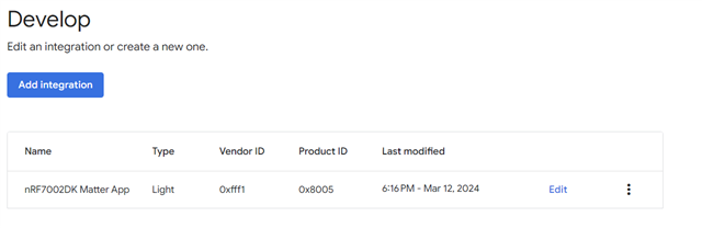

WiFi connection fails using Matter lightbulb sample
I am running matter light bulb sample. I have compiled it for nRF7002DK. I want to run matter over WiFi. But during the device setup I am observing a failure. nRF Device is unable to connect with WiFi access point.
Here is the details of setup I have and flow of test I am running.
Following the directions provided here https://devzone.nordicsemi.com/nordic/nordic-blog/b/blog/posts/matter-testing-nrf-connect-sdk-platform-with-apple-google-and-samsung-ecosystems-218911247#mcetoc_1gkq24ojdf I have added th vendor id, device id and other configurations in my google dev console. As shown in image below. I also have a google nest mini connected with same google account and wifi network.
When I try to add the device in google home app, everything went well untill WiFi connection. from the logs I can see the device was able to find the SSID in scan list. But the connection request was failed.

I: 29337 [DIS]CHIP minimal mDNS configured as 'Operational device'; instance name: 7BFCF0B5B325DCD8-0000000096449828.
I: 29348 [DIS]mDNS service published: _matter._tcp
I: 29352 [ZCL]OpCreds: successfully created fabric index 0x1 via AddNOC
I: 29360 [EM]<<< [E:44224r S:22227 M:9246544] (S) Msg TX to 1:FFFFFFFB00000000 [DCD8] --- Type 0001:09 (IM:InvokeCommandResponse)
I: 29371 [IN](S) Sending msg 9246544 on secure session with LSID: 22227
D: 29377 [DL]Sending indication for CHIPoBLE TX characteristic (ConnId 00, len 71)
E: 29385 [DL]Long dispatch time: 281 ms, for event type 16388
