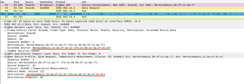

    But I have the following problem: I have Thingy:53 devices with the Weather_Station as end devices, and the Thingy:91 as coordinator. Previously I have developed a coordinator to set the binding for temperature, pressure and humidity clusters to do attribute reporting. I have developed this for the nRF5340 DK and works fine, it receives the reports. But when flashing into the Thingy:91, the coordinator sets the network, sends binding request, the end device sends success response, but the reports are never sent.
    I add two wireshark files, one using the nRF5340DK and other one using the Thingy:91.
    nRF5340DK.pcapngthingy91.pcapng
    Thanks for your help.
    The destination address in the Bind Request is incorrect in the Thingy:91 sniffer log.
    From the nRF5340 DK sniffer log:
    From the Thingy:91 sniffer log:
    As you see, the destination address of the Bind Request should be the same as the extended source address of the packet, that is, the coordinator's address in this case. In the Thingy:91 sniffer log, you are still using the extended address of the nRF5340 DK as the destination address for the Bind Request.
    Marte
    Yes, that was the issue. Thank you very much!
